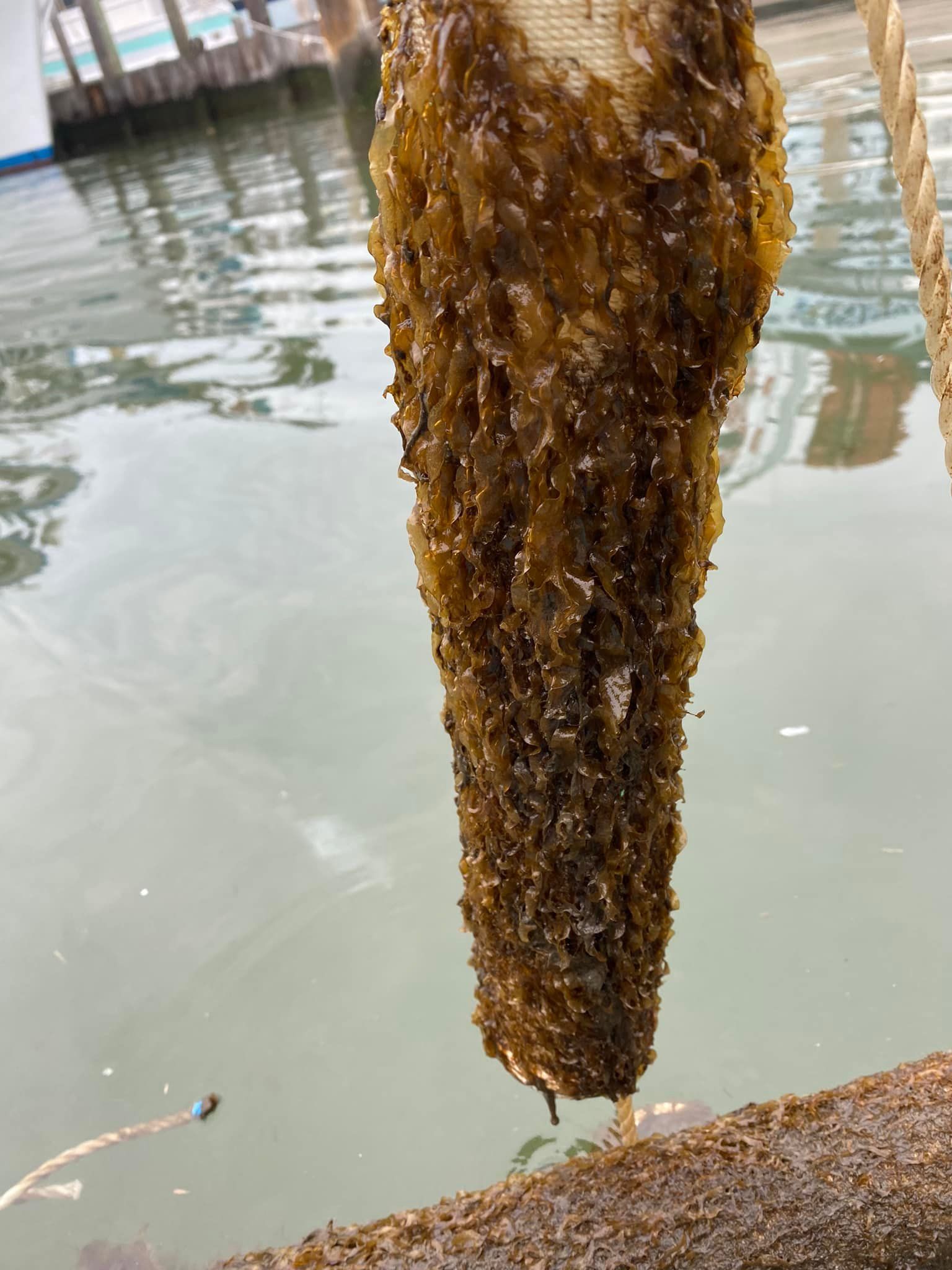

@simon_weber7356 I find that if I don't add more nutrients and water changes the sporophytes bleach quickly. The tips turn clear and brittle, then the spools quickly decline. I have had more success keeping spools alive in open water (hanging off my dock) after they are 6+mm (photo).
