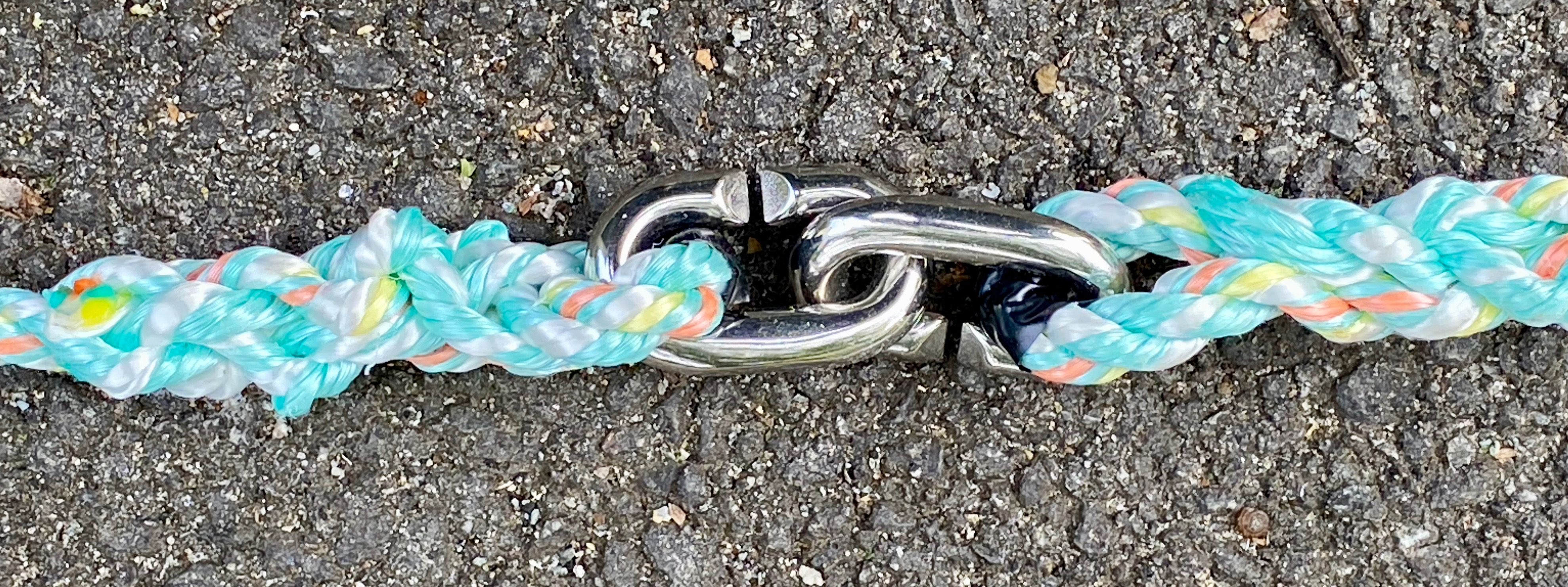

    @jerrard_willis We use C-Links exclusively for growline connections.
    Growlines are typically made 200-feet long, the standard seed spool length. We avoid shackles and knots at all cost with every connection a splice. These links are quick to open and close but will simply not come apart on their own and are available at most marine supply outlets.

  • mica_oherlihyM
    mica_oherlihy
    @clifford_goudey somehow one of our C- links came apart during our recent bomb cyclone…
