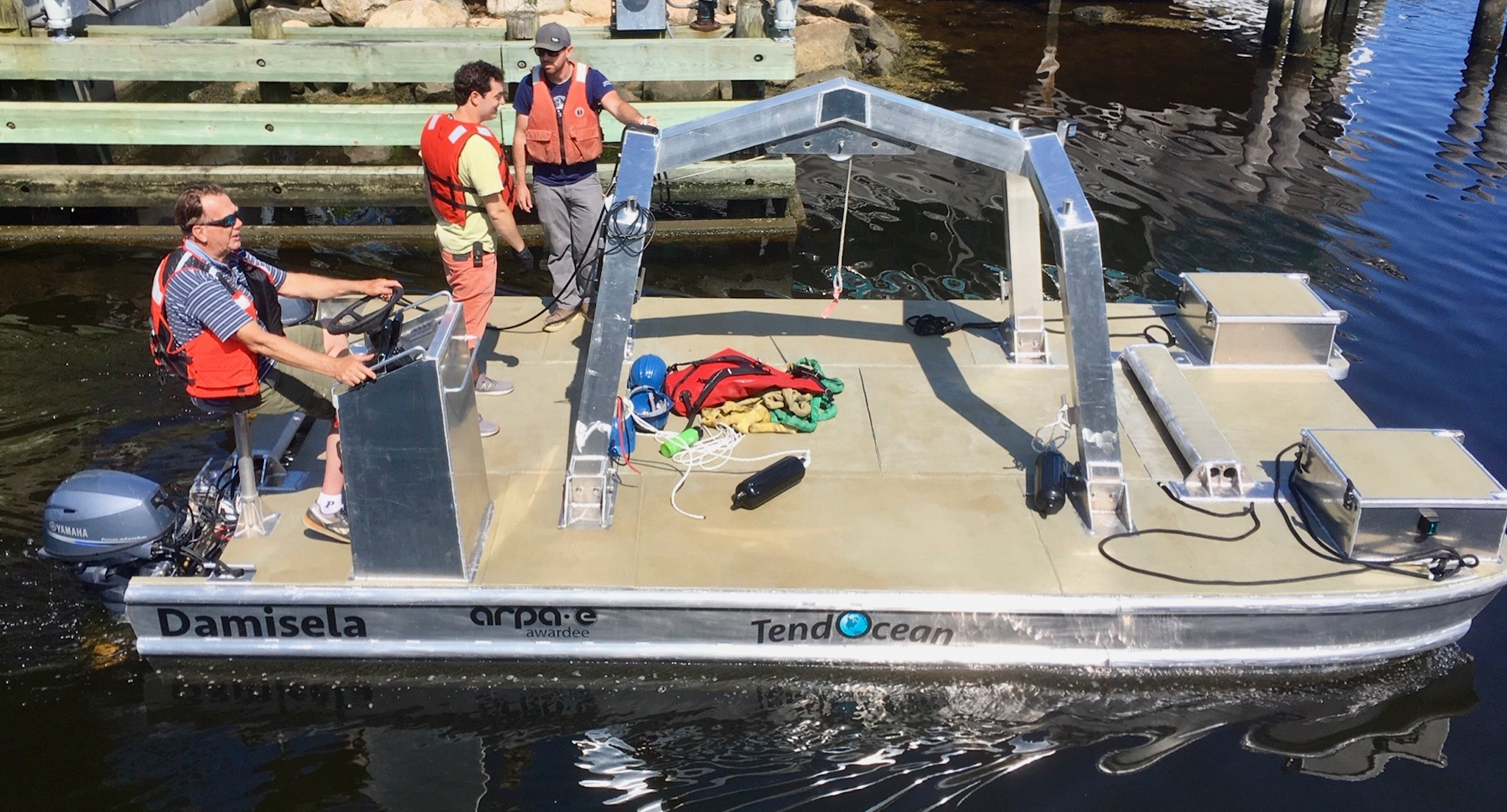

    Cody, of course a lot depends on the size of your farm, the exposure, the distance from harbor, and the planned level of mechanization. Alf’s set skiff mentioned by Lindsay has been a real workhorse on the Kodiak farm and for two of the seasons it was used as the harvest vessel. However, for the initial installation of the anchors and spar buoys, we used a larger seine vessel.

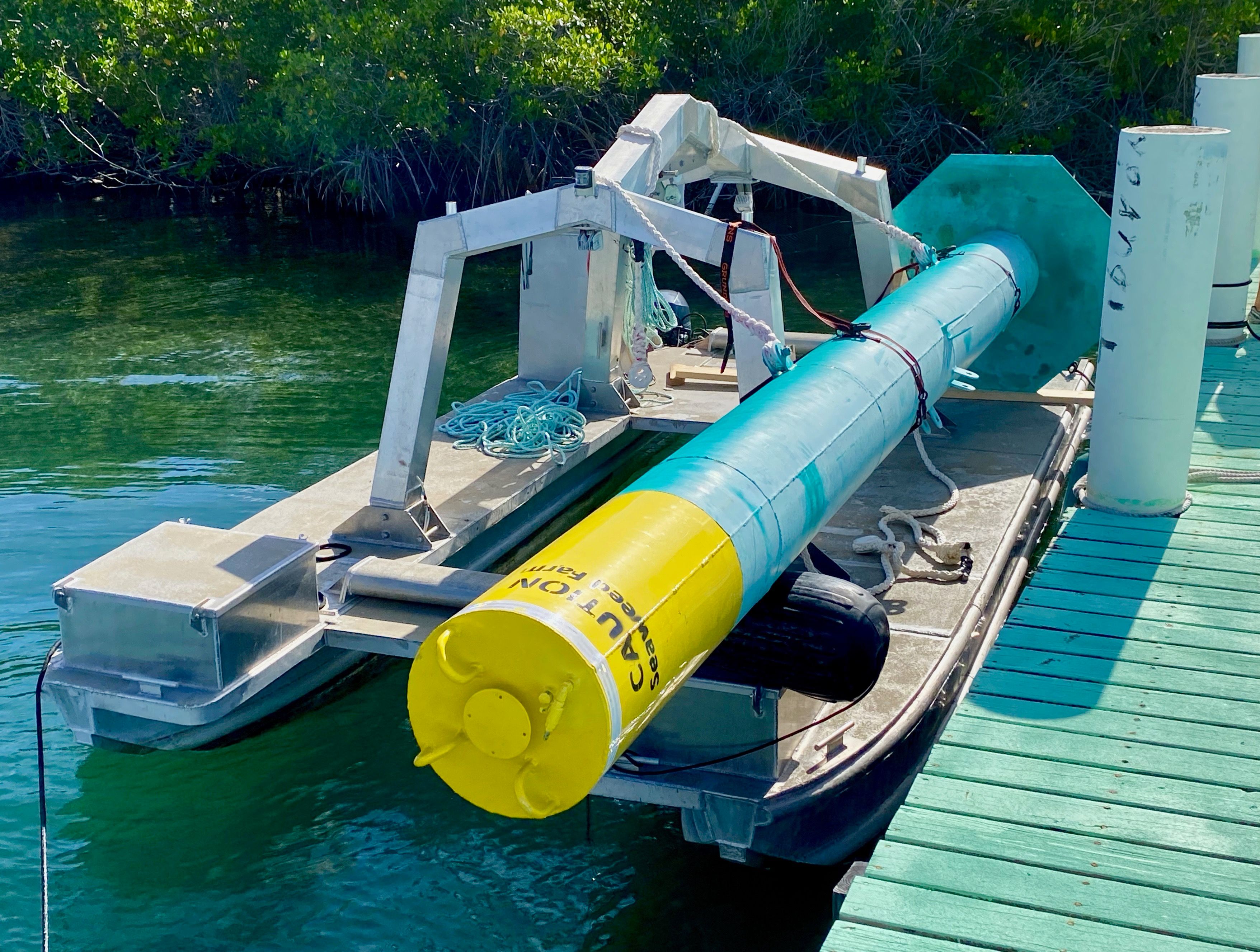

    At the Puerto Rico project we have taken a different tack, designing and building a catamaran that would be the day-to-day service vessel but also capable of installations and harvest. Damisela was built by Wilson Welding of Salisbury, MA, and disassembled, stuffed into a 20’ container, and shipped to La Parguera for re-assembly.
    We used it to install and tend a 5-line array for over a year and recently used it to install the project catenary array including the eight anchors and the four variable-displacement spar buoys.
    The gantry has a 5,000-lb hoisting capacity. We are planning to exploit the space between the for mechanized planting and harvest.
    The choice between using and adapting an existing vessel vs. a custom design such as Damisela depends a lot on what’s available and if it is to be dedicated to the farming operation.
