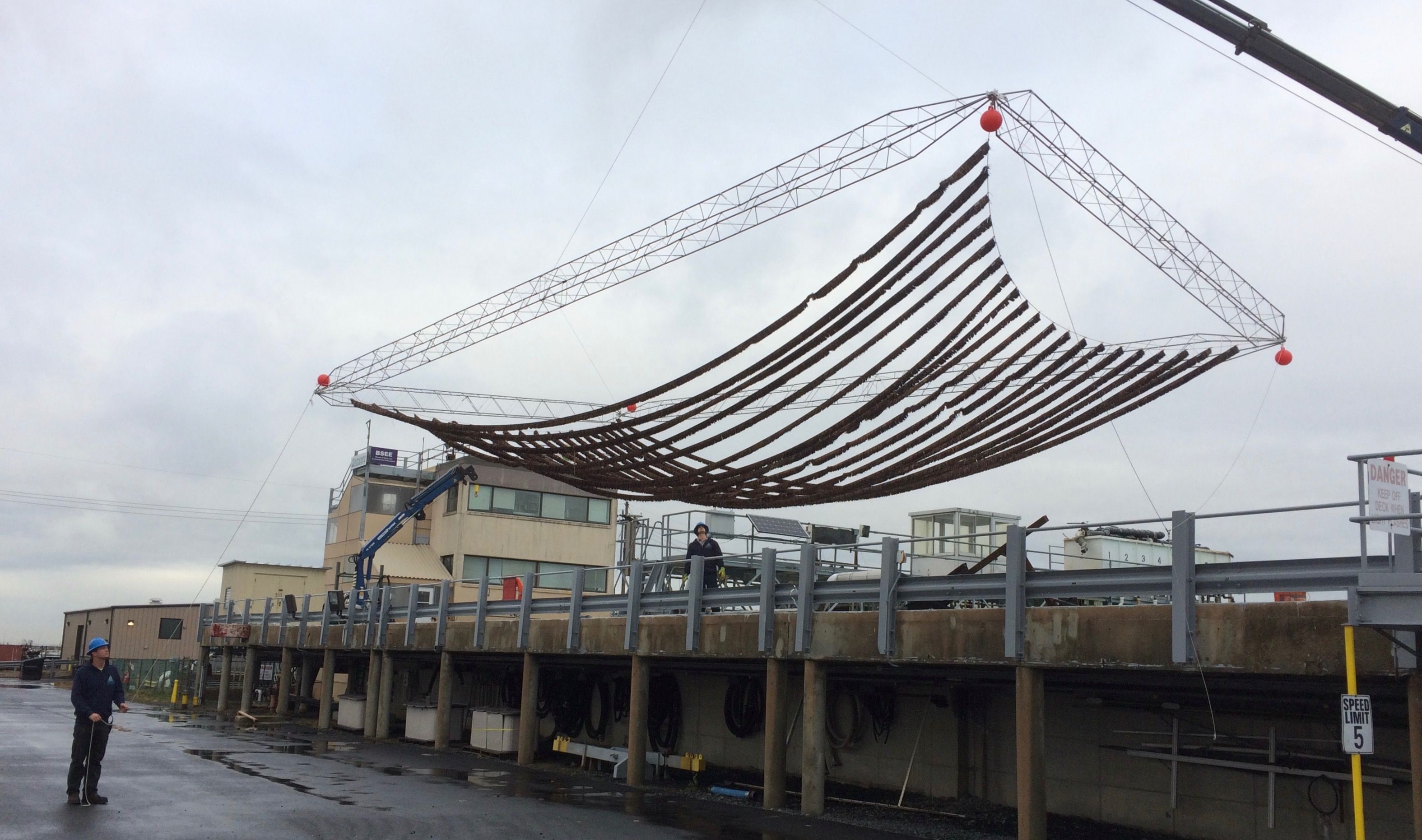

    But believe me I understand the motivation - lots of room, fewer conflicts, more stable temps, etc.  That was my motivation when I explored the same question a few years back.  With funding from NOAA SBIR, we tank tested a structural framework that would be able to swing on a single-point mooring.  This is the sixth-scale model we tested, all loaded with simulated kelp.

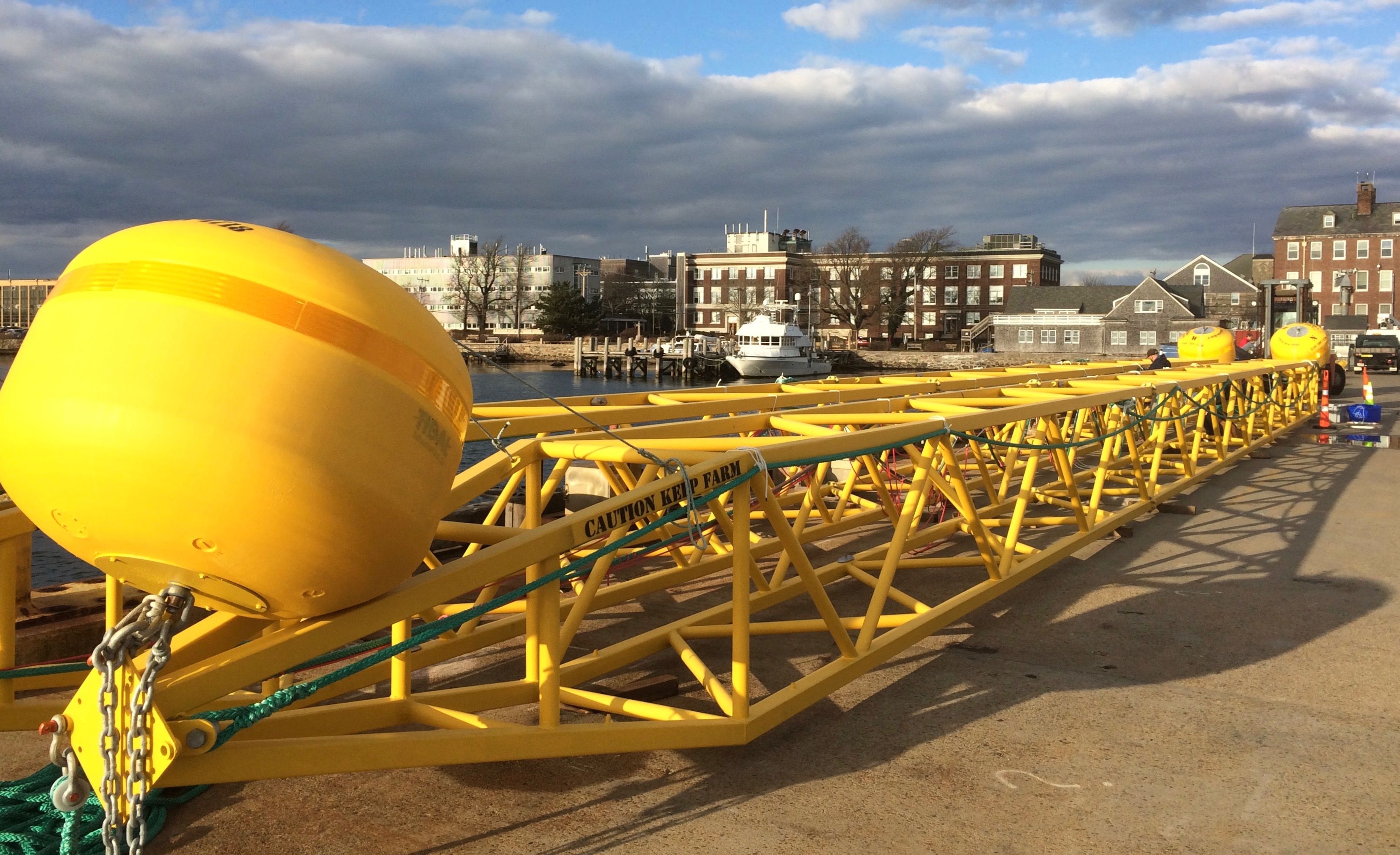

    It worked great in the tank and probably could have worked in real life but who can afford it?  What we ended up doing was forgoing the super-long longitudinals trusses and tested a rig with a pair of the transverse truss frames. that would be moored between a pair of opposing anchors.
    Here is a photo during deployment in Woods Hole.  Each truss was 33m (108') long, a 4'-square welded steel truss supported at each end by a pair of commercially available buoys.
    The results, you ask?  A miserable failure when the buoys self-destructed under the wave conditions experienced at the site in the middle of Nantucket sound.  A lot was learned and the system was later successfully re-deployed using proper cylindrical spar buoys and was in service for several years as a WHOI research farm.  I'd be happy to share more details is anyone curious.
