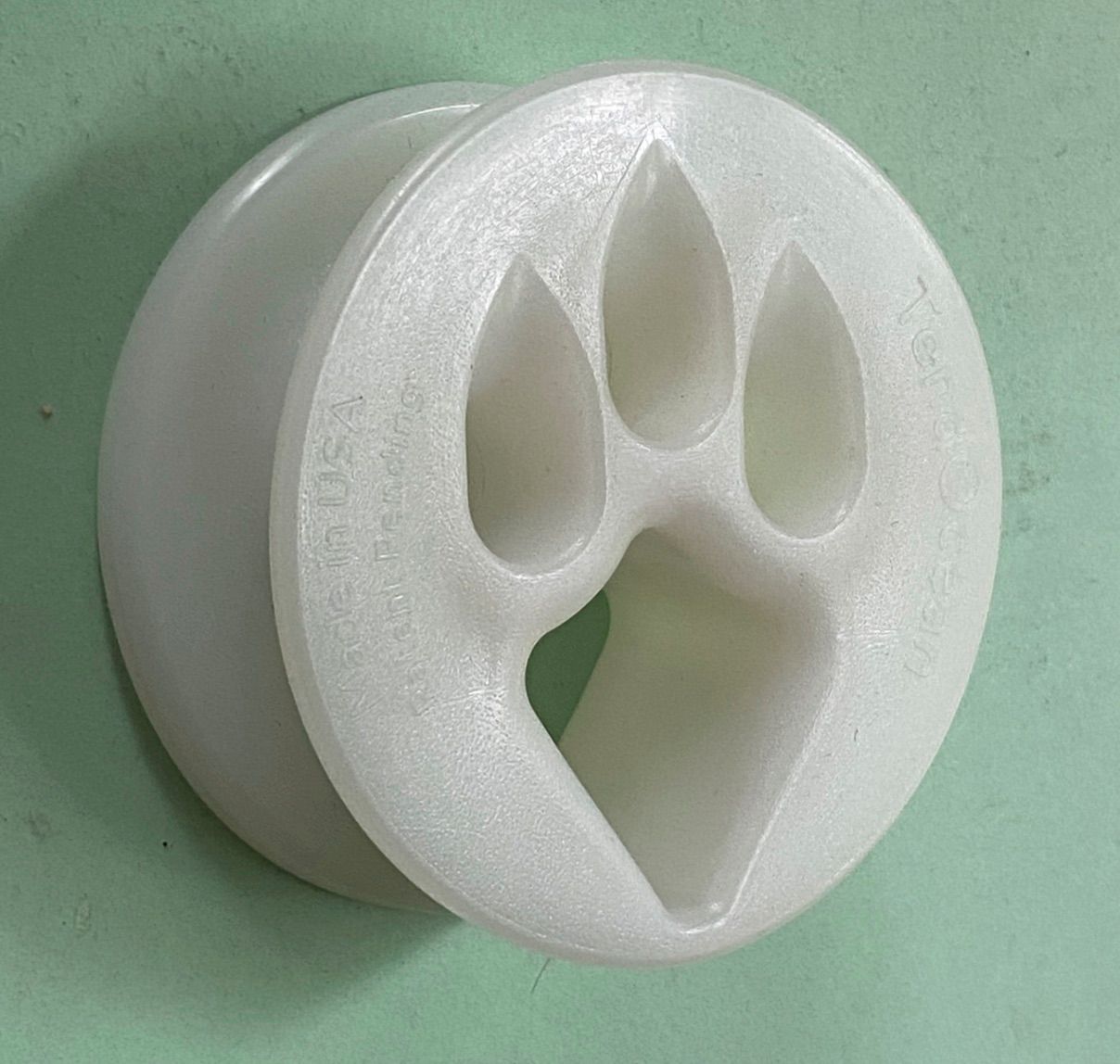

Deadeye tensioners are an underwater block and tackle with no moving parts. You can insert whatever adjustability you need based on the amount of line you include. We've found 10' of adjustment is enough. This is what they look like molded in HDPE.
Let me know if you're interested.

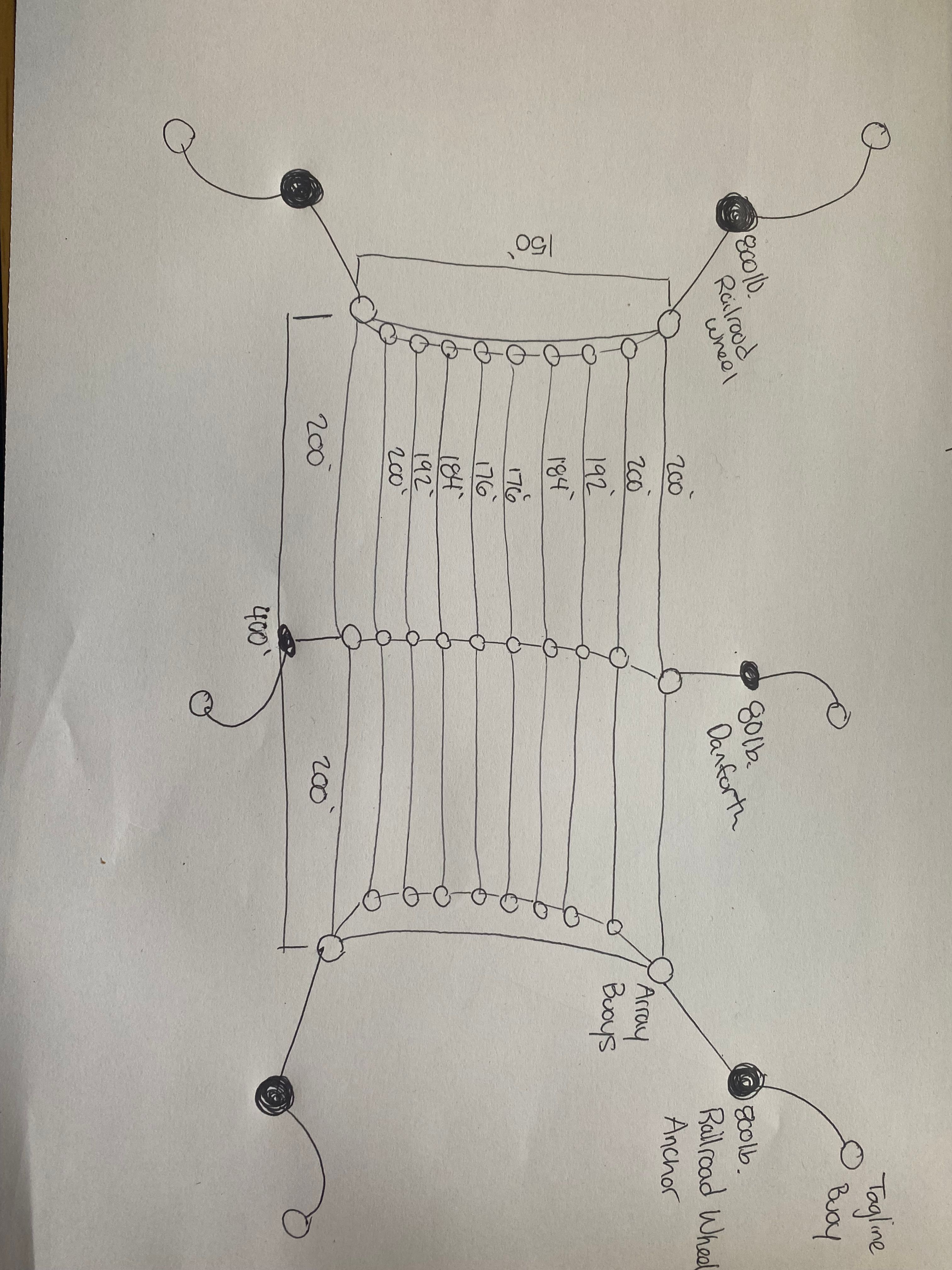

Yes, we had 16 total grow lines in a grid-like system. Lines are roughly 200 feet each. They attach to the perimeter and the mid-line with "tag lines" connected with a seine ring and snaps. Here is a rough schematic.
It does seem like we need an alternative way to tension besides moving the anchors. I am interested in getting some deadeyes in place this fall. It sounds like we might need 16 of these dead eyes? Is that correct? Could you advise on the placement please?

The main problem with your drawing is the assumption that your two end lines are straight. They are not and that's why they are more properly called catenary lines. Like the cables on a suspension bridge, in order to provide uniform tension across your eight growlines, you have to build in the right amount of inward sag. You can still have uniform growline lengths but you have to make up for things by having variable length tag lines (we call them extensions). When this is done right, things work pretty well and you can enjoy close growline spacing because everything moves in unison.
We generally put two anchors, 90˚ apart, at each corner to provide some redundancy. That also allows us to stack these catenary modules both width-wise and length-wise. However, a single anchor at some outward angle can work.
In your case, a tensioning rig should go at the very top of the anchor line where you can best reach it for adjustments.
I'll reach out to you via email with some more specific advice.

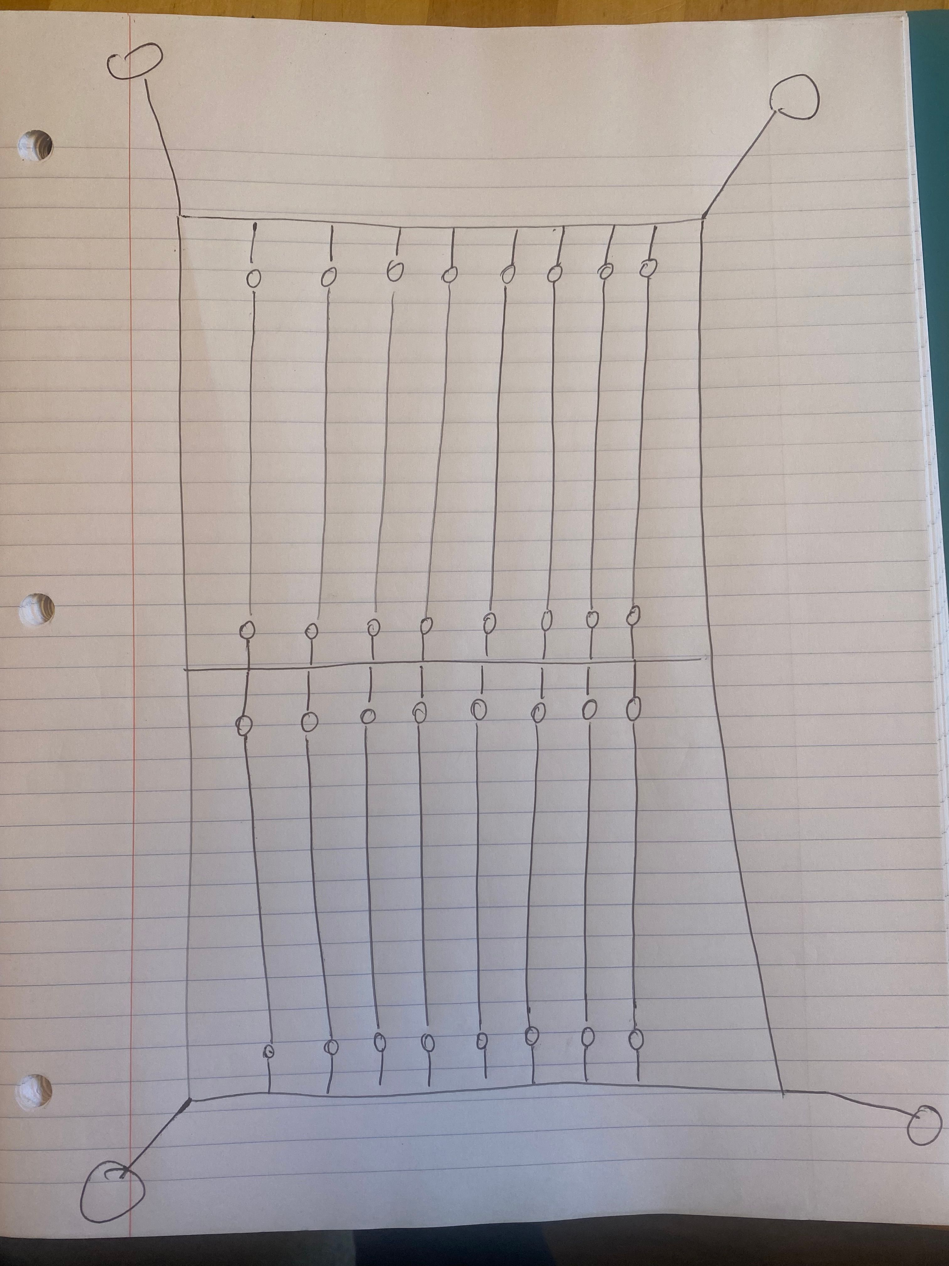

Just wanted to follow up from our previous discussion. We have a better drawing of our array now, which I am attaching here. Our array is somewhat (not completely) perpendicular to the flow of the current.
Questions I'm still wondering about:

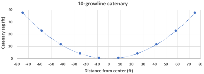

Your sketch is beginning to make sense to me. The precise lengths of the individual growlines can be calculated but a lot depends on the shape of the catenary line. Because I usually use a pair of orthogonally positioned anchors of the same size, I like to have the ends of the catenary approach those anchor lines at 45˚. In such a case, the center growlines are shorter than the outer ones by half the catenary width. In your case 200’ outer ones would call for lines in the middle to be 162’ long.
Of course, by using a single anchor at each corner, you can decide ahead of time what that angle should be. On the other hand, a shallow catenary means most of the system loads are from the tension needed to supply the outward force. IMHO, 45˚ is a good compromise.
Also, instead of shortening those center growlines and wasting seed string, consider making up your catenary lines with permanent growline extensions of specified length and have a straight row of C-links or other connector across that intersection with full-length growlines.
Here is a table of the extra length needed for the growline extensions as you move out from the middle with 16.67’ spacing between growlines.
Growline # Growline extension (ft)
1 0.46
2 4.17
3 11.57
4 22.69
5 37.50
Also, note that the separation between attachment points along the 172’-long catenary line increases as you get to the end. I’ll send all the dimensions to your email. This is what the catenary will look like.

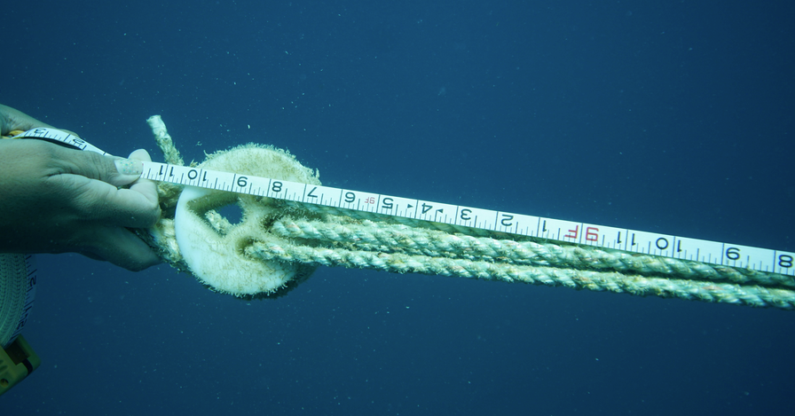

Yes, a deadeye tensioner at the intersection of the catenary and the each anchor line should do the trick. Here is a photo on one being used on the ARPA-E farm in Puerto Rico.
