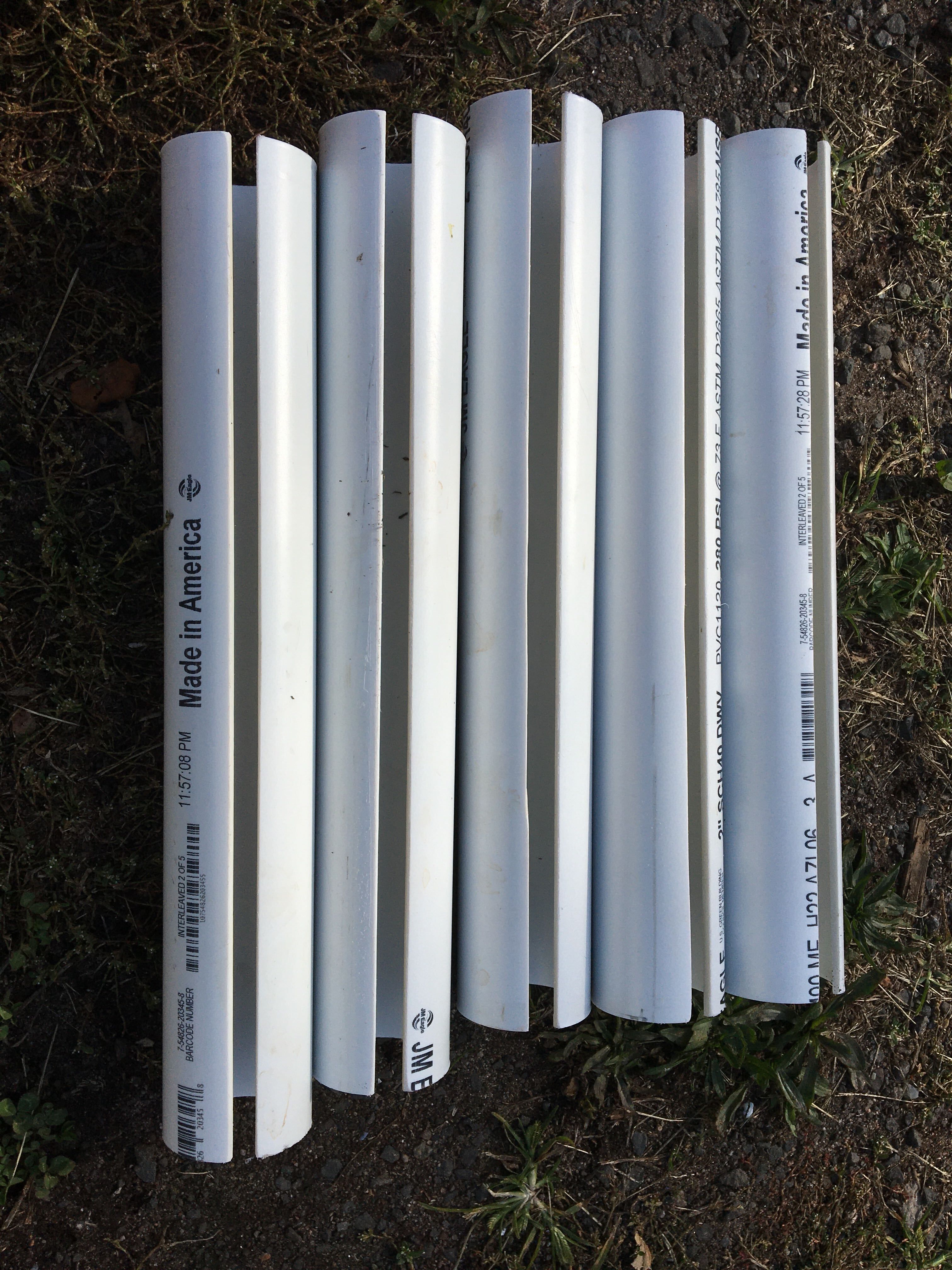

    I'm looking to add slits to our 4" PVC (Schedule 40) spools so they can be pulled off long lines after outplanting (rather than untying the long line from the anchor line).
    Has anyone experimented with or are currently using 4" PVC w/ slits to make spools spools?
    I have some concerns:
    1.  I've noticed when removing a large slit from the spool the gap closes, decreasing the diameter of the spool thus hold less seed string.
    2.  When cutting a small slit it makes it difficult to open the slit enough to pull 1/2" long line through.
    3. I've tried thinner walled sewage pipe, but it's too malleable and causes the spool to collapse on itself.
    Anyone have any guidance? The photo below was a trial we did with 2" spools.
    kendall_barbery
