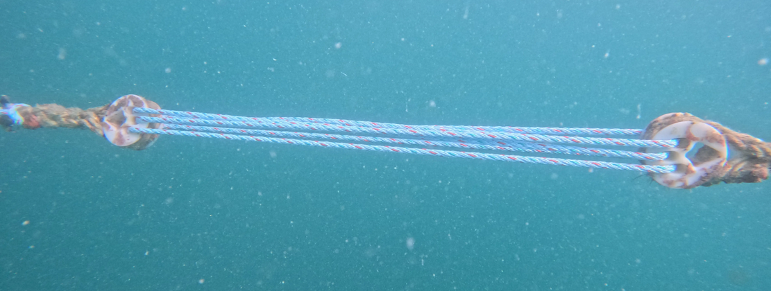

@tobias_stevensfleming47 The hub has a section on dead-tensioners here including a video of the system underwater.

@tobias_stevensfleming47, I've never compared the creep or Polysteel to other rope formulations, but I think some permanent stretch over time is inevitable with most synthetic lines. With single-line rigs its a simple matter of re-tightening things at slack low water. With multi-line spreader bar rigs where the individual lines are carefully measured to be equal lengths, system tightening must occur at one of the anchor lines. However, loads there are much higher and things become difficult.
The deadeye tensioning system was developed to solve this and is installed on one or both ends of the array between the spreader bar bridles and the top of the anchor line.
It is essentially an underwater block & tackle with no moving parts. The two deadeyes are molded in high-density polyethylene, which is slippery enough to provide a 6:1 advantage. It's best to use a braided line for the tensioning line, as 3-strand tends to twist things up, increasing friction.
If you reach out to me at cliff@cagoudey.com I can provide you more details. Thanks for the mention, Loretta.
