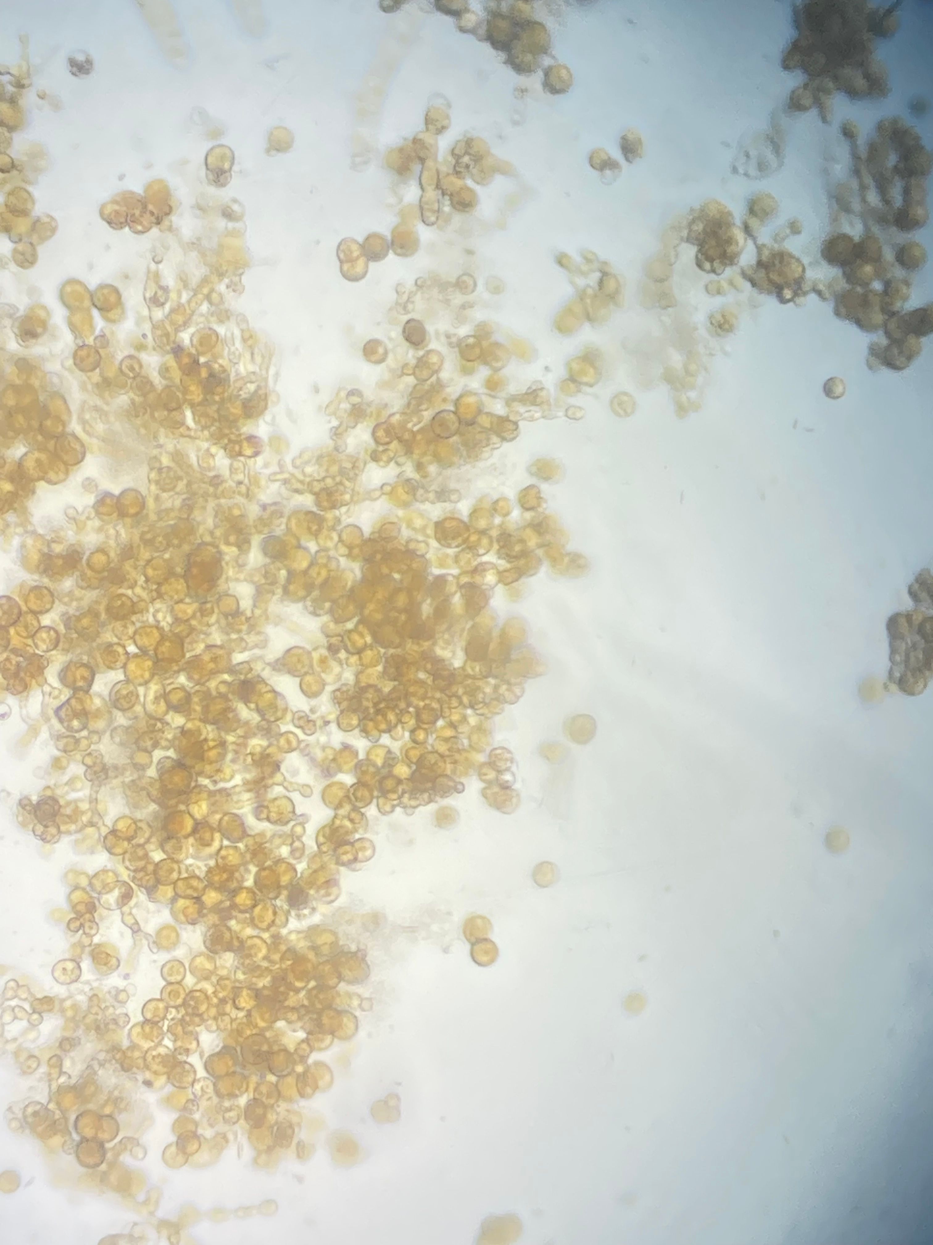

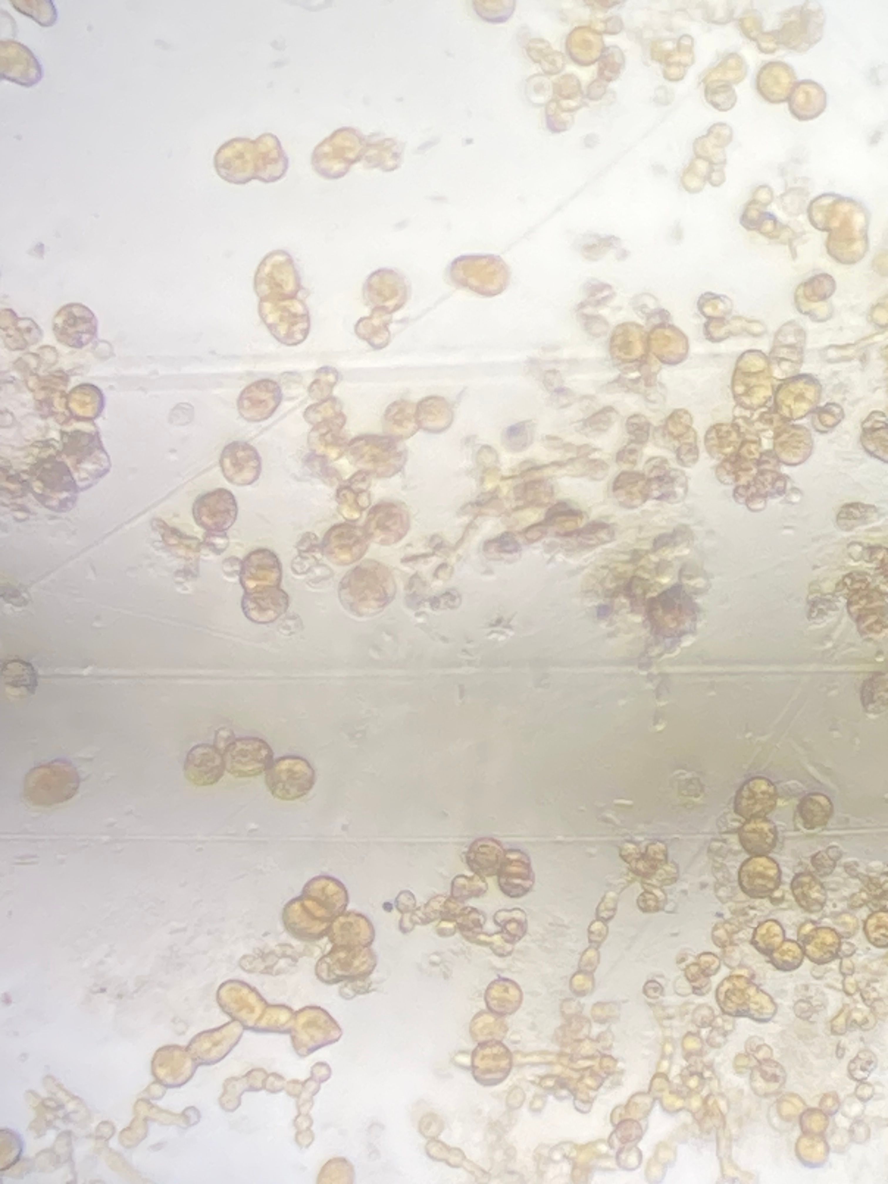

    I was wondering if anyone has experience with phaoevirus in their gametophyte cultures, or could help me identify why my female gametophyte cells are spherical and enlarged?
    I would like to use these cells this season, even experimentally, to see if they reproduce and grow. I’m hoping someone here has experience with this.

    Hi @elizabeth_savage19 and thanks @leeann_ennis for tagging me in this!
    I unfortunately have not seen this before, so I think the papers suggested by @toby_sheppardbloch are a good place to start. I will share this post with the other algae people at UBC to see if they know more than I do.
    I am very interested in disease, so depending where you are located I would love to get a sample! I'm sure many labs would feel the same. Academics are usually hoping to do something relevant to the boarder community, so finding collaborator to tell you what is in your cultures should be possible.
    In terms of testing, there are two main molecular approaches we can use:
    1. PCR - Good when you have an idea what you are looking for as it really serves to confirm the presence of a particular organism. This is much faster (~2 weeks) and cheaper (~10$ per sample on the high end). It is also possible to look at a few samples and it being economical for labs. This is probably the only one that would have the turn-around that you need.
      1. Illumina amplicon sequencing - Good when you have no idea what you are looking for. This is what you would want for a bacterial bloom, because you can know everything that is in your sample. This is much slower (~2 months if fast) and expensive (~35$ per sample on average). It is not economical to run a few samples at once. This is interesting in the long-run for research and to learn about your nursery but probably not a good choice to make within growing season decisions.
    Please let me know if I can clarify anything else and if you are near(ish) Vancouver BC and are willing to give the Parfrey lab at UBC some samples! If you are far away I can suggest some labs that have the expertise you are looking for that are close by.
