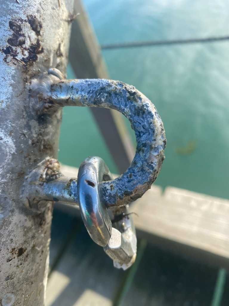

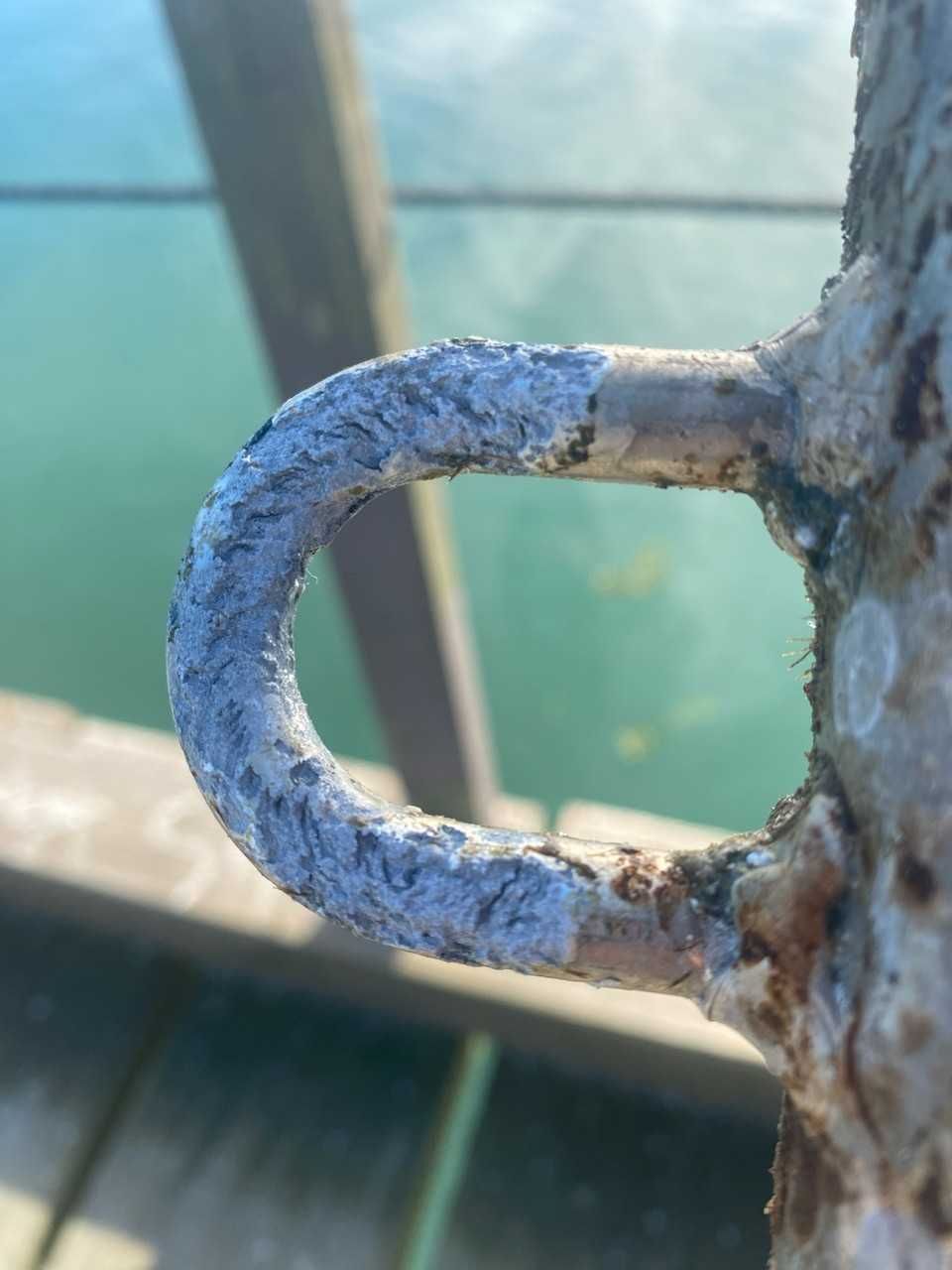

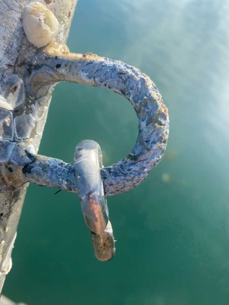

  • kendall_barberyK
    kendall_barbery
    @clifford_goudey Thanks for weighing in, Cliff! Super helpful.
    Per Cliff's comment (2. Spreader bar material) I'm sharing a couple of images of the galvanic corrosion that occurred on our spreader loops when we had a stainless-to-aluminum connection on our farm in California. Usually, we splice a line to the spreader bar and c-link. In this case, we made a decision in the field to eliminate that line due to spacing constraints and went for a direct c-link to spreader connection. We were able to reinforce the spreader loops after the first farm season, but don't let this happen to you!
