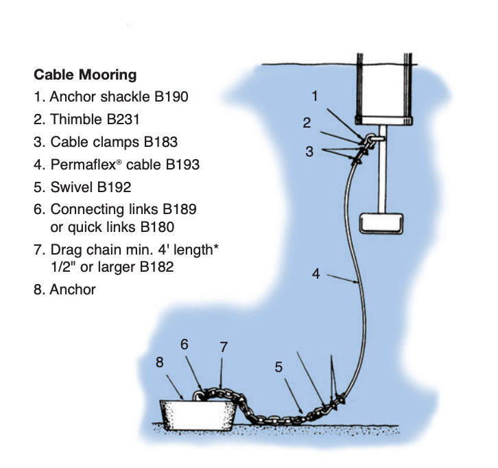

    @jill_pegnataro @clifford_goudey for our Humboldt Farm, we used the rigging recommended by the buoy manufacturer (basically coated cable - PermaFlex -attached to a 300# flat concrete anchor; see attached image from Rolyan Buoys, one of a handful of RMB manufacturers in the states). Our site is pretty protected from the forces of the open ocean, but currents can reach 3.5+ knots. Our bottom is muddy, so the anchors stick pretty well. We've only had the gear in the water for about 18 months, but all looks good -- no wear observed and they haven't budged. Cliff's homemade anchor is of equivalent weight, likely really good at sticking to a muddy bottom, particularly, and a lot cheaper than a manufactured concrete anchor. We've found that swivels are key for these single point systems!
