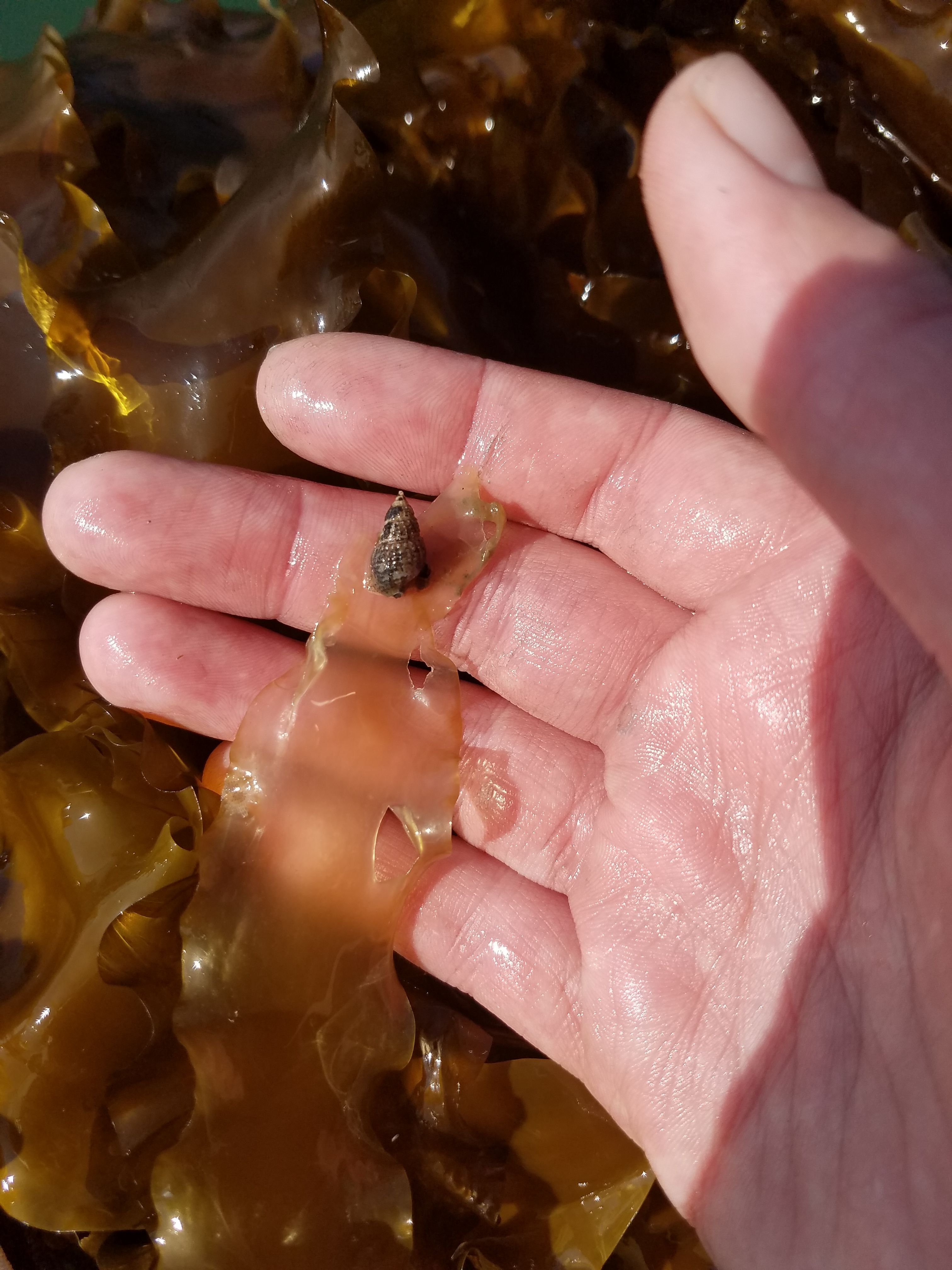

If you had a good season the kelp could be up to 10-12ft long. If that is the case and your site is in shallow water, you could be introducing new critters like snails to your crop. Snails will eat holes in the kelp and make it difficult to sell for food consumption. You can help prevent this by making sure your lines are tight and off the bottom at low tide. You can also trim the dead growth on the bottom that will eventually need to be trimmed before going to the processor. If the lines are loose and you can see mud on your kelp you need to get that kelp off the sea floor.

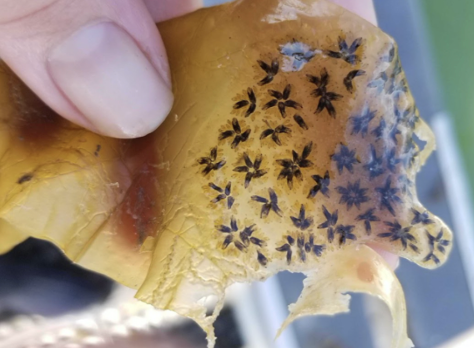

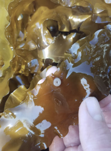

As a farmer you also need to be aware of biofouling. As the waters reach 50 degrees there are new organisms in the water column that will find a home on your beautiful crop. Although that is great for create new habitat on the reef, that is not so good for processing for food consumption. You need to keep a close eye on your crop as the waters start to warm up. You may only find a few biofouling organisms here or there, but as the waters get warmer they will quickly multiply. Make sure that you are in close contact with your processor at this stage. You may need to make a decision and harvest sooner than you originally planned to save the crop from biofouling further.

Below are some pictures of biofouling you might find on your crop.
@jill_pegnataro -
I recognize the sea squirt eggs and the snails but what type of epiphytes are the top two pics?
@suzie_flores - based on the Guide to Common Biofouling Organisms it looks like they're hydrozoans (Obelia spp., sea fur) and Botryllus schlosseri, Star tunicates.
