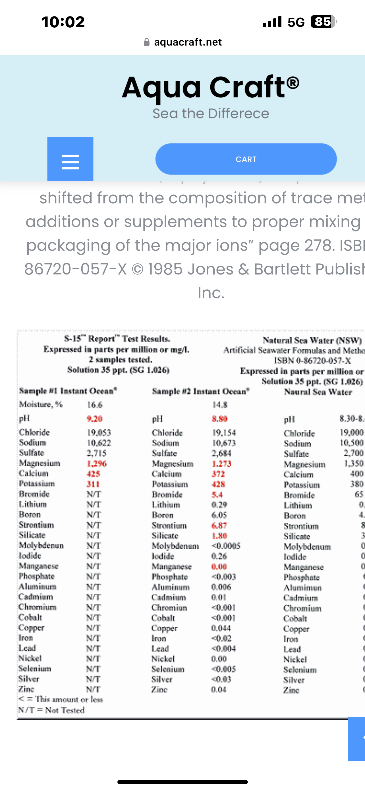

    @mike_spranger Hi Mike! I know diatoms can be a real threat to growing spores. I recommend to try to remove the silicate from the water that you are using. There are various methods that you can find online (E.g. filtering, RO, Calciumhydroxide). Because the diatoms are using the silicate to grow and reproduce, taking it away should significantly reduce the potential growth. Germanium dioxide would be a nice addition, but you mentioned it's very difficult to obtain for you.

    @tristan_s hi Tristan. I’m using Instant Ocean. Can you advise if this has silicates that should be avoided?
  • tristan_sT
    tristan_s
    @mike_spranger The report that you provided states that the second sample has 1.8 mg/l of silicate in it. The recommended amount should be below 1.0 mg/l to combat diatom growth. It's interesting to see that there are almost no trace minerals in the first sample. Just out of curiosity, what is the difference between the two samples?
  • mike_sprangerM
    mike_spranger
    @tristan_s hey Tristan, I may have posted a chart that confused matters… I googled instant ocean ingredients/specifications and that’s what I got. I’m not setup to use actual ocean water and I believe instant ocean is the best and most widely used alternative for this purpose so I’m not sure what other choices I have…
  • tristan_sT
    tristan_s
    @mike_spranger Hey mike, I think all the marine salt may contain traces of silicate. If would recommend treating the the marine salt before using it for hatchery purposes.
