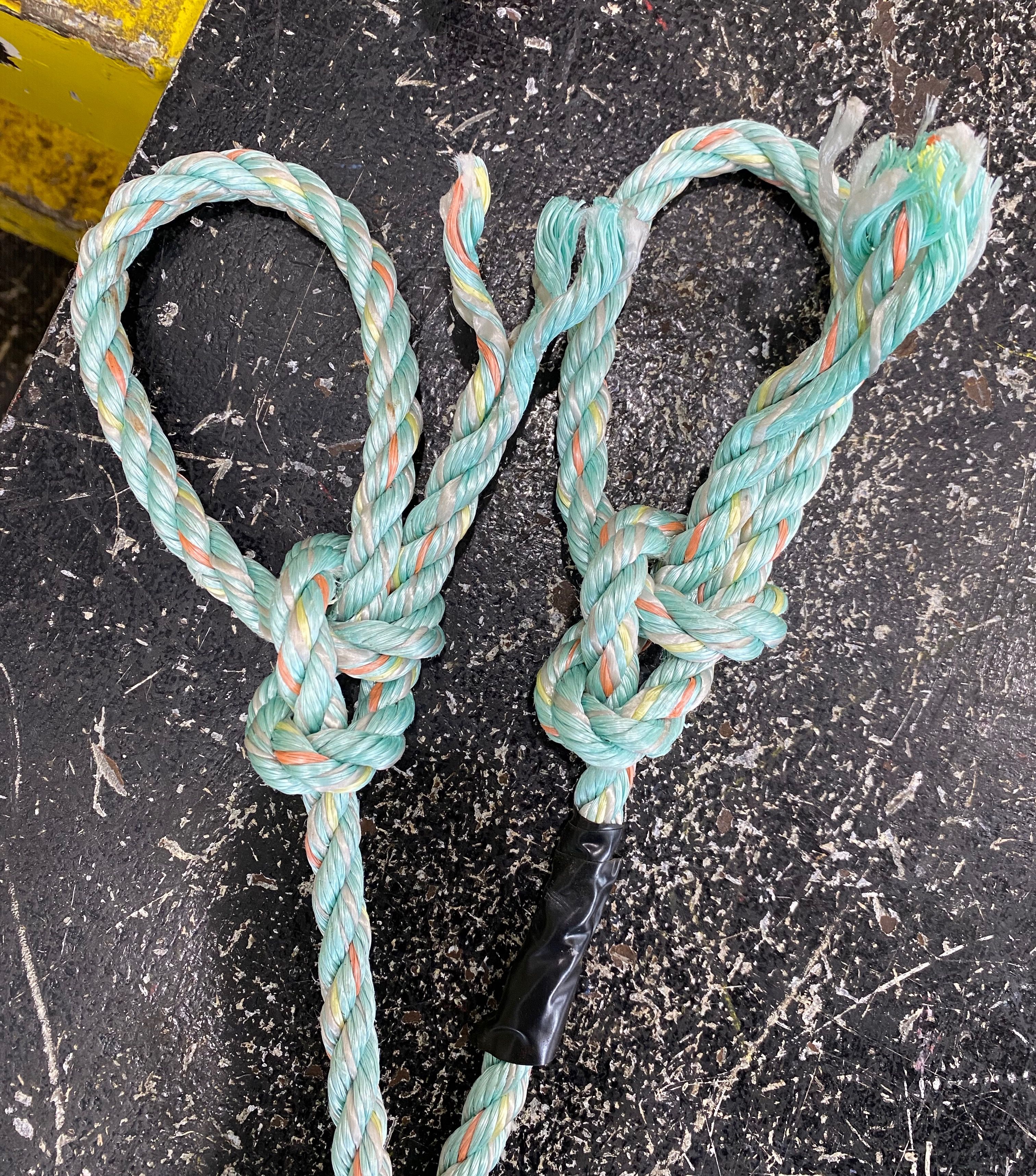

    We were at the WHOI rope testing facility testing connectors when the topic of how best to tie a bowline came up. As we all know, when the rabbit comes up from his hole, he can run either way around the tree before ducking back down. That choice results in two different looking knots.
    On the left we have the bitter end exiting to the outside and on the right the bitter end comes out in the middle. That's the way I'm used to tying it, but which is better?

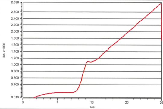

    So we pulled this piece of 1/2" Hydropro with a tensile strength of 5,000 lbs to see which knot held. Here is the result.

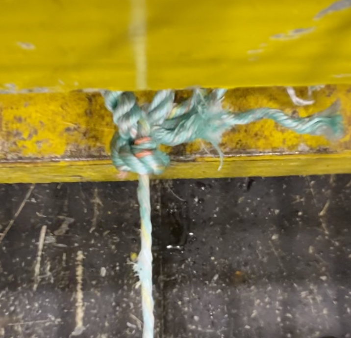

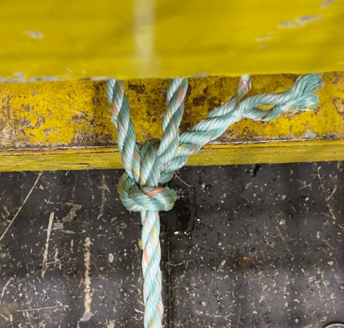

    The knot on the left failed at 2,861 lbs, 57% of the breaking strength. It was a one-shot deal so we do not know if the other knot was going to last much longer but it looked OK. I can't seem to post a video, so here are the video frames just before and just after failure.

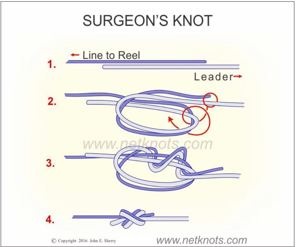

    @mike_spranger This knot, used by fishermen also, can be an alternative, depending on the application
