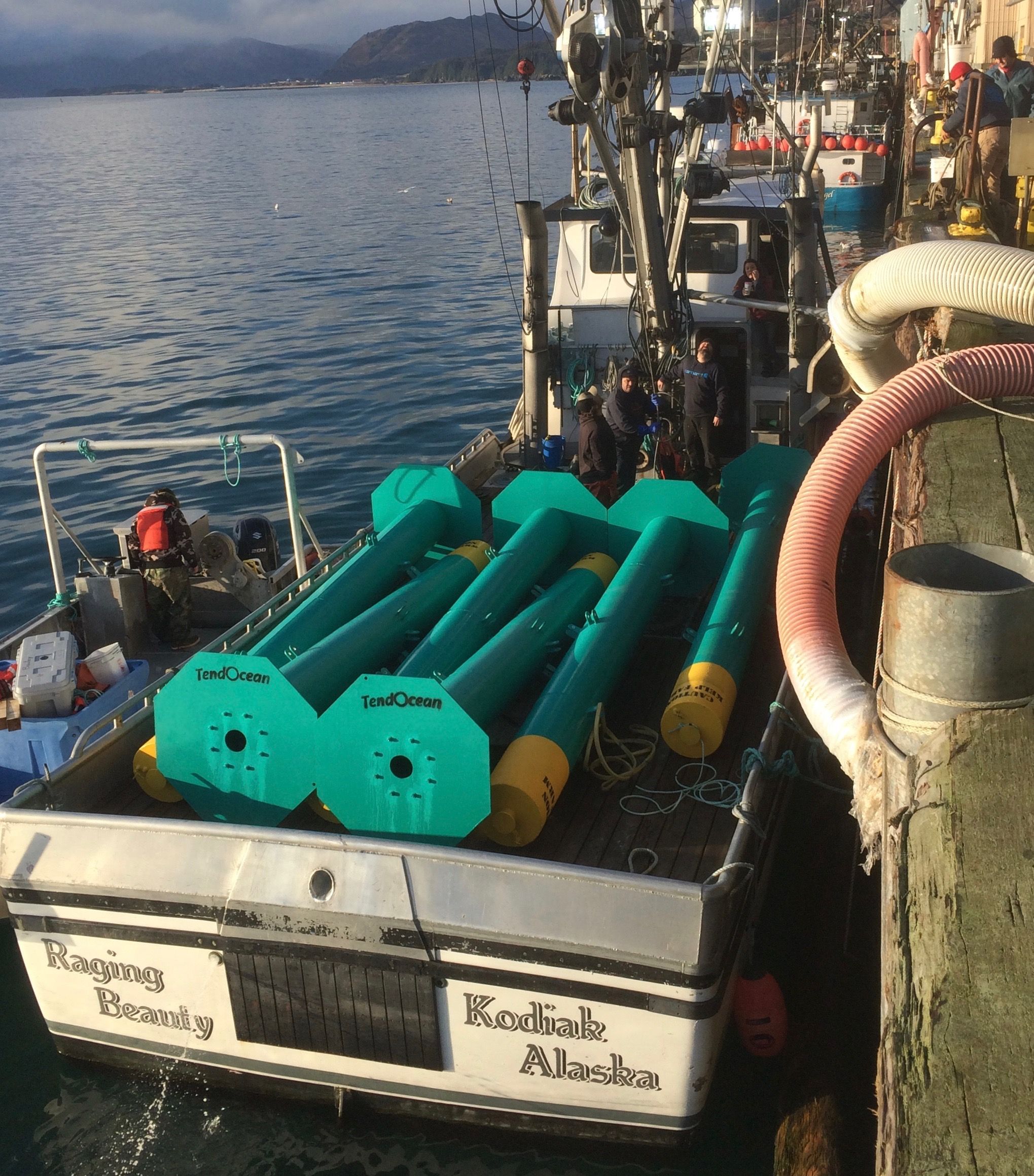

    Jasper, there is a big difference between a system for controlling the depth of the farm and one to do so automatically.  I'm not convinced that for normal farming methods automating such a feature would be worth the trouble.  Responding to seasonal growing conditions or the varying needs of different stages of crop maturity seem like sufficiently rare events that I'd want to be on site and tend to those activities in person.
    The variable-displacement spar buoys (VDSBs) that we've developed for our catenary modules have proven handy, but mostly for raising the system during deployment and growline installation, or for making adjustments to compensate for crop weight.  It's a simple matter of adding or venting air from the lower chamber of the buoy.  The system has worked well in Kodiak and next month a similar rig will be installed in Puerto Rico.
    With that tropical system we will be utilizing the VDSBs ability to be sunk to the bottom upon the threat of a hurricane.  In that case, remote triggering of the sinking is planned but clearly not something we'd  "automate" by watching the barometer fall.
    For more information see:  https://www.tendocean.com/prod...
    Cliff

  • clifford_goudeyC
    clifford_goudey
    Jasper,
    The main motivation for the tall, slender spar buoys is to eliminate the excitation that gets inserted into a farm from typical spherical or squat buoys that have most of their flotation concentrated at the sea surface.  I think that sort of heave resistance is useful in protecting the crop at its earliest stages of growth and likely reduces snap loading on the system and its components during weather extremes.
    I also sense that in coastal waters there is sufficient mixing (at least in the winter) to provide nutrient mixing throughout the water column.  I'd be interested in hearing if there are measurements to the contrary.  Anyway, depth cycling chasing nutrients is not anything we are considering.
    Cliff
  • clifford_goudeyC
    clifford_goudey
    @jasper_mallinson - I want to update this discussion of nearly 2 years ago when I stated, "depth cycling chasing nutrients is not anything we are considering." Things change, and lab results and research by others have revealed that there may be practical value in depth cycling under some conditions. The challenge, of course, is to find a method of doing it that is simple, robust, and sufficiently cost effective.
    In collaboration with the MBL Tropical Seaweed Project supported by ARPA-E and led by @loretta_roberson, we have developed system for raising and lowering a 108' x 200' catenary farm off the SW corner of Puerto Rico. Because of its exposure to hurricanes, the ability to sink seemed a prudent idea. However last summer surface sea-water temperatures rose prompting us to sink the farm for most of August and September. At the same time experiments looking at the effect of nutrients and light on growth rates have suggested spending more time at the bottom (It's a 60'-deep site) would enhance growth rates and allow more frequent harvests.
    We've recently shipped a new set of four variable-displacement spar buoys (VDSBs) to the farm and this month we will be installing them for testing. These VDSBs include a compartment for an 80 cf scuba tank, an radio link, electronics, and valves to allow their remote-controlled sinking and timed recovery. Air is vented from and subsequently added to the VDSBs ballast chamber to effect these movements. A well-trimmed farm (meaning one with a proper amount of buoyancy or weigh to balance the crop) can be cycled multiple times between scuba-tank changes. Will the enhanced growth rates be worth the hassle? Answering that question is the purpose of the experiment.
    Cliff
